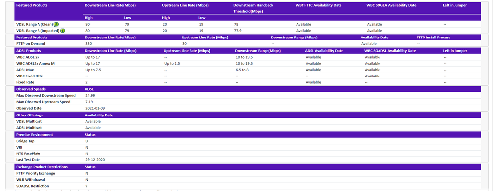

Message 10 of 18
Re: Bit confused over broadband speed
Oh sorry, was that the link to this?
