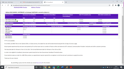

What exchange and cabinet are you on, you can look it up here.
5,030 Views
Message 5 of 9
Re: Broadband Area Fault
All looks ok to me but I am no expert?
Summary says FTTP not available but everything else says available.
