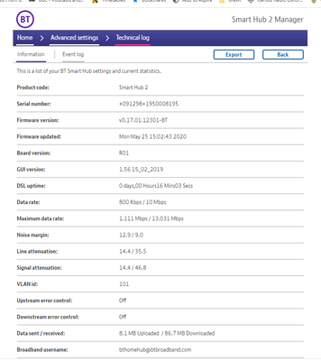

if now connecting at 10mb can you post hub stats please
2,997 Views
Message 26 of 27
Re: Broadband Fails to meet USO
Here you are...
2,986 Views
Message 27 of 27
your noise margin is 9db so if you just maintain connection I would expect that to drop to 6db with your speed increasing nearer your attainable - but needs to be stable - no drops/resets
