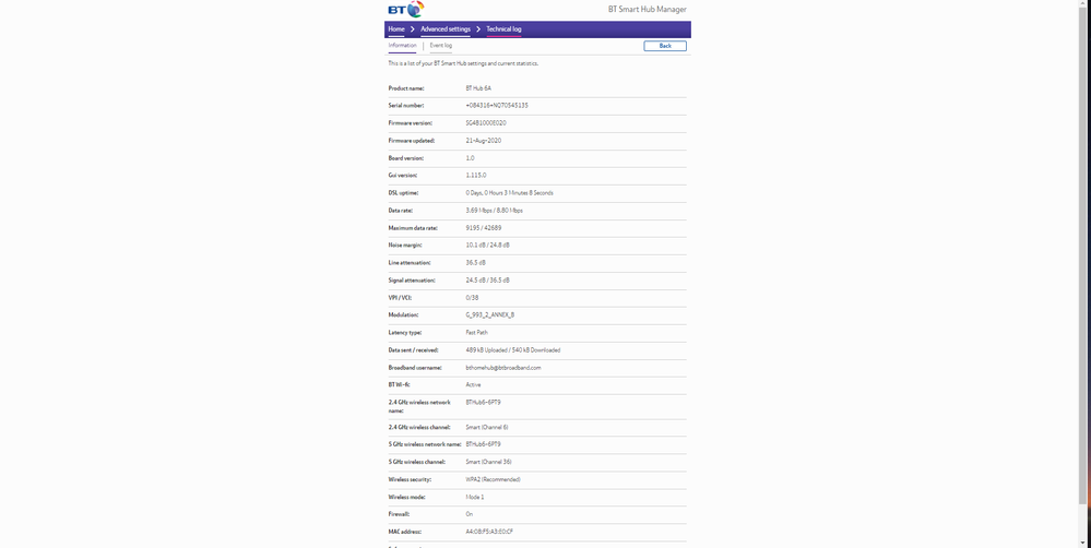

Re: Broadband Problem
Go to solution
Your connection speeds up/down are really poor. Are you able to take front of the master and use a new filter and connect hub and repost stats please.  When in test socket can you check again for dial tone and any line noise

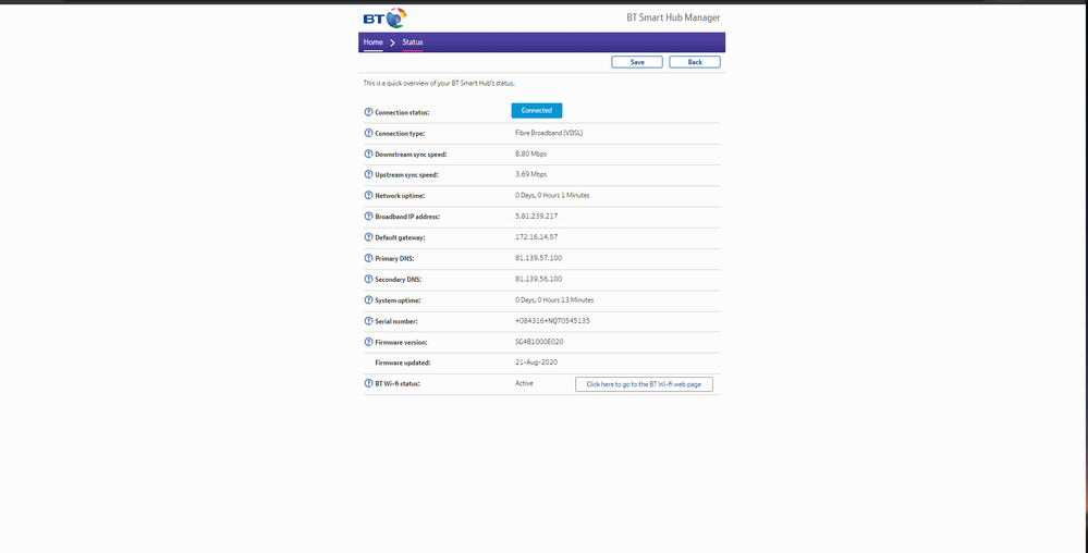

These are the stats with a new filter and done quiet test in a test socket, still no sound at allBT NOWY FILTR.pngBT NOWY FILTR 2.png

@DawidM1
The very high downstream margin means that you are stuck in a banded profile, and DLM (Dynamic Line Management) has detected an issue with your connection, and reduced your actual speed from 42Mbs to 8Mbs.
This can also be caused by you either disconnecting, turning off, or restarting the home hub. This is seen as a fault. It must be left on 24/7.
You must now leave it connected all of the time, no disconnections, power offs, or restarts, and eventually your speed will recover, but its likely to take a few weeks.
