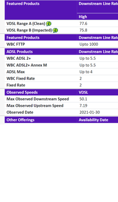

Might be worth downloading speedtest.
Another way for VDSL/G.Fast is to look at the wholesale checker and it shows you the observed speed it has seen as a reference.
ie

What does the wholesale observed speed say ? and what "up to" speed are you paying for ?
