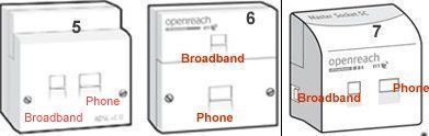

please can you post the full stats page
which master socket do you have

Hi Thanks for the reply.
I have the master socket number 7, there is only one phone from this socket, which I don't usually have plugged in. I have tried removing the socket and plugging the cable from the HH6 directly into the incoming line (using a microfilter) but this made no difference to the speed. The issue appears to be outside the premises.

Unclip the faceplate and connect to the test socket with a filter and repost stats.
Check for line noise again and if still present report a noisy line fault not a broadband one.
