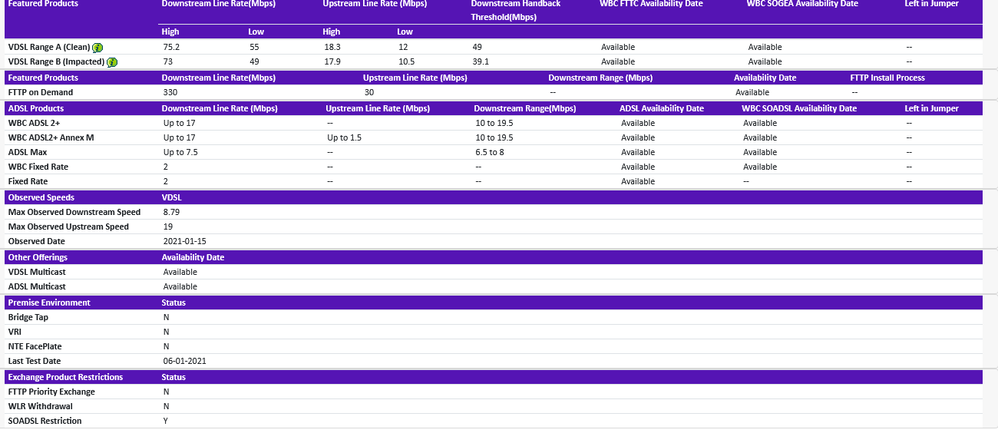

is it a broadband fault or a phone line fault?  do you have a dial tone?  if so dial 17070 option 2 should be silent and best with corded phone
 please can you post the stats from your router (if hub enter 192.168.1.254 in your browser) and if  HH5 then go to troubleshooting then helpdesk and if HH6/SH2 then advanced settings then technical log information .
enter your phone number and post results  remember to delete number   https://www.broadbandchecker.btwholesale.com/#/ADSL
looks like you need to report a fault again

Hi imjolly, thanks for replying. Its a broadband fault. I've dialed 17070 and there is noise on the line but i only have cordless phones.
the result of the tests

The most you should get with a cordless phone is a dull background hum. Report a noisy phone line fault not a broadband one.
