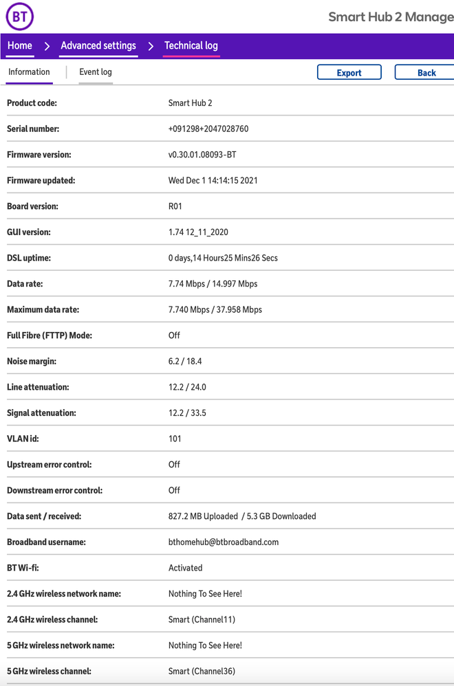

For reference, here's the Technical Log from the Home Hub:
Router Technical LogRouter Technical Log

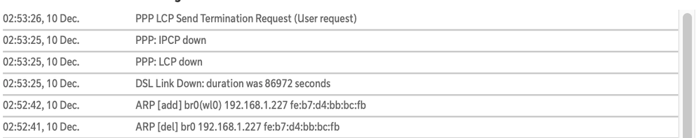

As far as I can tell, the DSL connection is being reset every night. Here's the snippet from last night's Event log:

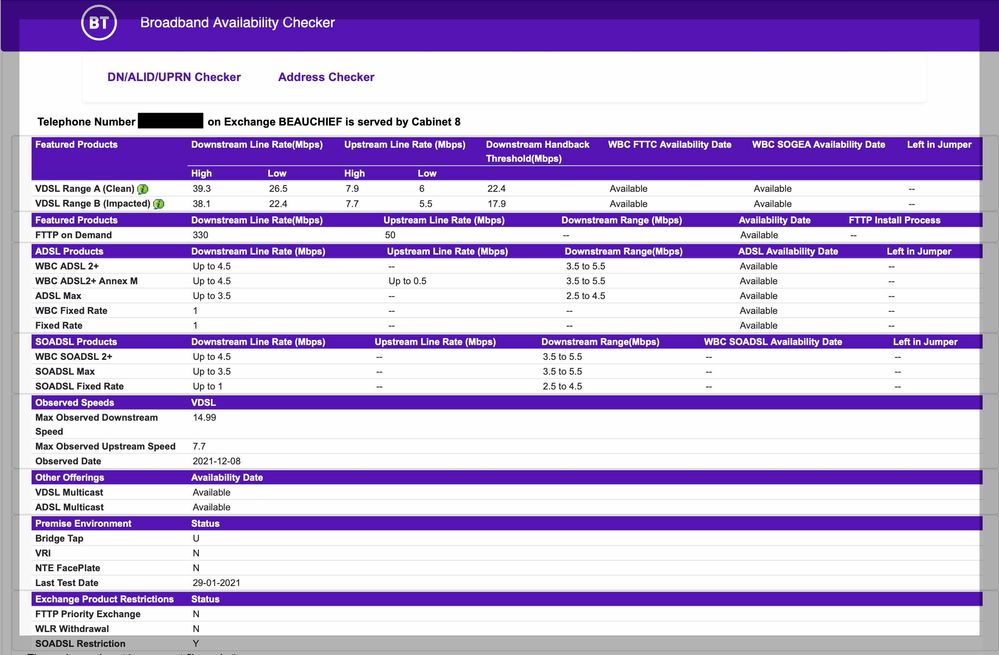

And from the Availability Checker:

Your connection time is only 14 hrs is that due to hub dropping connection or manual  reset or maybe a combination of both.
Try quiet line test. Dial 17070 option 2 should be silent and best with corded phone.
BT will not be capping your speed but if your line is unstable then the DLM will lower your speed to try and stabilise your connection

The hub loses the DSL connection every night. It was around 02:53 this morning and 02:44 the previous morning, 00:32 the morning before, etc.
This is not a manual reset and the power hasn't gone off

A second OpenReach engineer came out last Monday. He tested the line, then reset the card in the cabinet and our downstream speed jumped up to 39Mbps. According to the engineer, if there is an electrical glitch or power-failure in the cab, the card can lock the speeds at an unnecessarily low level. The clue (for him) was that downstream was exactly 15Mbps.
Since the engineer reset the card 6 days ago, we've had an unchanging 39Mbps downstream with 8Mbps up and the DSL line has not dropped at all.
