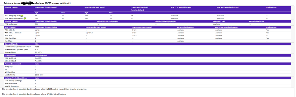

Whatever they have don’t hasn’t improved matters, as your max attainable is now 37Mb yet at the end of May you had an observed speed of 42Mb.
Even though the OR engineer has effectively  just left , have you been in the test port and done the 17070 quiet line test and checked for noise ?
If your up time isn’t very long and you are ‘DLM’d  from your current 31Mb to closer to 35Mb it’s still worse that you had previously
I presume the OR engineer meant the cabinet and not the exchange when they mentioned distance, assuming your line is clean ( not impacted ) 40-58Mb is what you would expect, I would be tempted to not close the ‘fault’ ticket

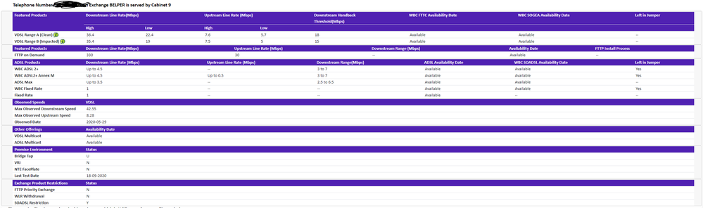

Appreciate the replies, I had the number of the engineer and left them a message and they kindly just visited again as they had finished another job early.  They said they had switched me onto another pair (whatever that is) and less errors on the line.  Just resynced at 44mb and 10 upload.  I just tried the VDSL checker link (see pic) and weirdly even though I'm synced at 44mb it's saying a  VDSL range of 36-22, any ideas why that is?  I hadn't heard of g.inp speed boost.  When that kicks in and DLM kicks in what could I reasonably expect as a boost from 44mb?  Best wishes,
3,916 Views
Message 9 of 9
Re: Broadband reduced from 44mb download to 31mb after engineer visit
you really now just need to wait and see how your line settles no they have again moved you to a different pair
