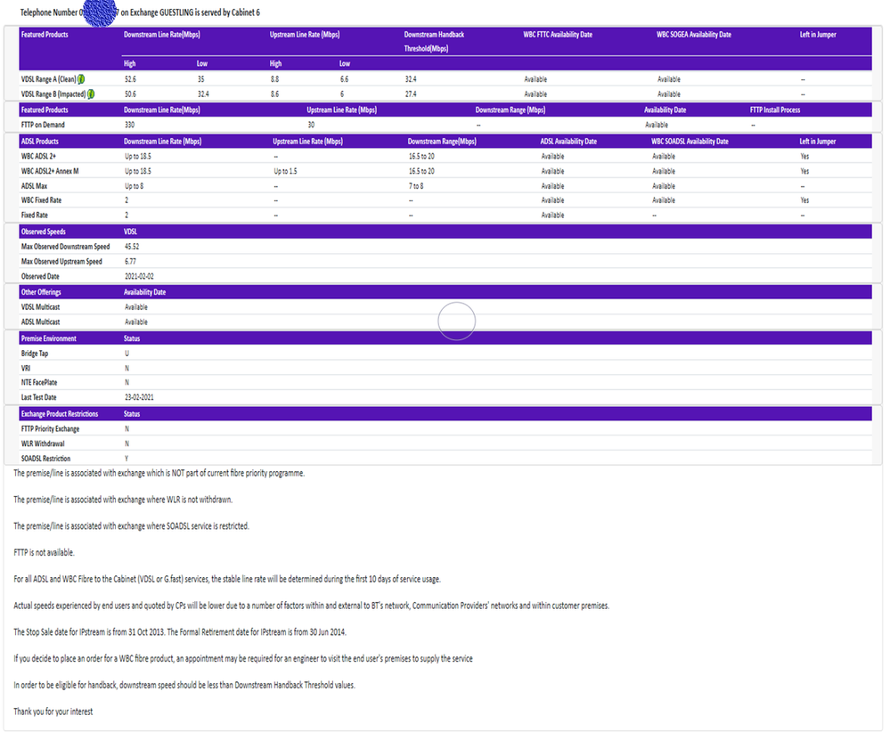

in order for the forum members to help please can you post the stats from your router (if hub enter 192.168.1.254 in your browser) and if  HH5 then go to troubleshooting then helpdesk and if HH6/SH2 then advanced settings then technical log information .
Have you tried the quiet line test? - dial 17070 option 2 - should hear nothing - best done with a corded phone. if cordless phone you may hear a 'dull hum' which is normal
can you run btspeedtester with an ethernet connection not wireless and post the results when download appears ok and again when download speed appears slow
https://www.speedtest.btwholesale.com/
enter your phone number and post results  remember to delete number but leave exchange and cabinet number
Someone may then be able to offer help/assistance/suggestions to your problem

Had this same issue a while ago. Had to go through lots of hoops with BT and in the end I just emailed the CEO of Openreach and he got it sorted straight away (They monitored the cabinet DSLAM at peak times). Link to my thread below, it may help you. It was basically a capacity problem at the cabinet itself, so BT couldn't actually see any issues, as the packets were being dropped there, rather than at their exchange equipment. The cabinet is Openreach equipment. They added extra fibre links from the exchange to the cabinet and now there is zero slow down at peak times.
I will say though, I think the only reason Openreach went the extra mile was because I had already exhuasted all of BT's line checks / engineer visits etc. So really there was only one possibility but make sure you have done all the BT line checks and congestion checks first. If you want to go this route, I just Googled for the email of the CEO of Openreach. Or PM me and I will send you the email address for the manager that I was passed on to.
