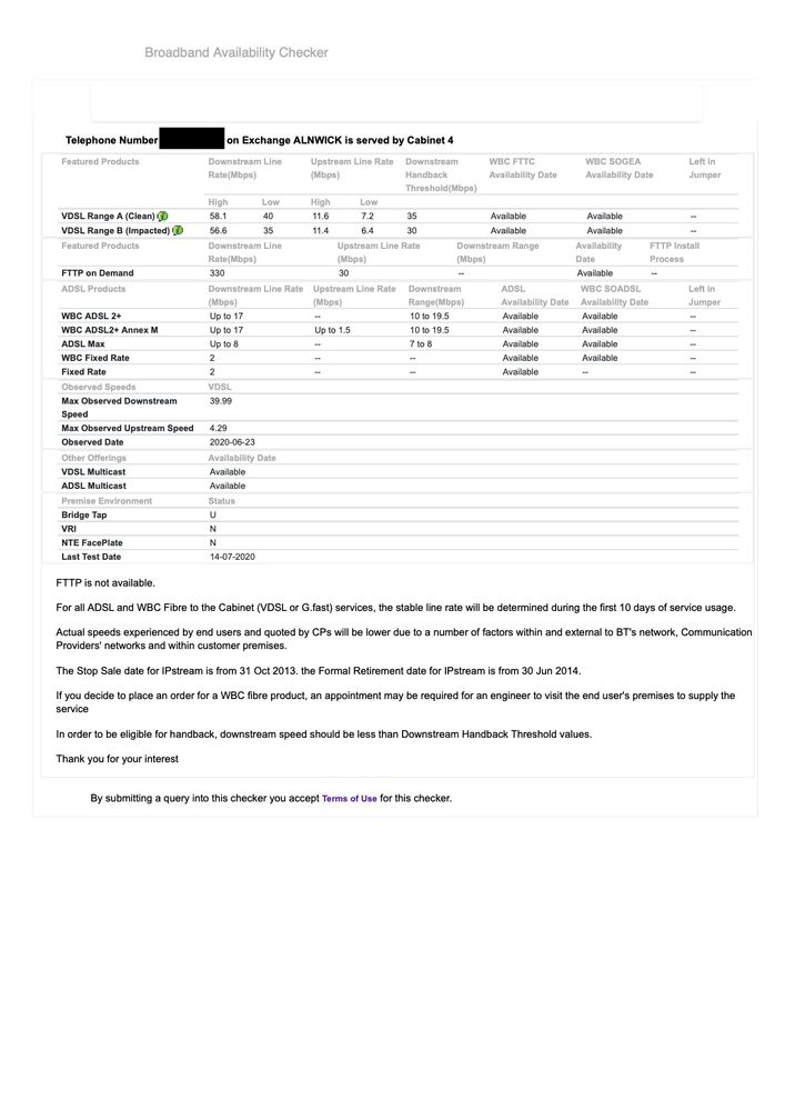

enter your phone number and post results  remember delete number but leave exchange and cab

when line was fixed on 5/6 has the hub been dropping connection or have you been resetting in hope speed would improve and then hub has been stable since start of July.  it now looks like you are in banded profile hence why speed appears fixed at 40mb
as it has been stable for 24 days I have asked mods to see if anything they can do to help  they will post here but are busy so may take a few days
