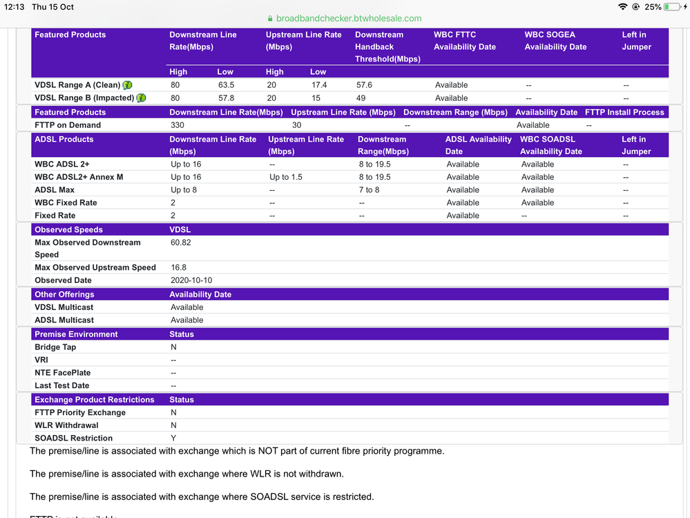

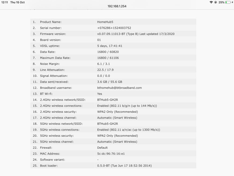

in order for the forum members to help please can you post the stats from your router (if hub enter 192.168.1.254 in your browser) and if  HH5 then go to troubleshooting then helpdesk and if HH6/SH2 then advanced settings then technical log information .
Have you tried the quiet line test? - dial 17070 option 2 - should hear nothing - best done with a corded phone. if cordless phone you may hear a 'dull hum' which is normal
enter your phone number and post results  remember to delete number   https://www.broadbandchecker.btwholesale.com/#/ADSL
Someone may then be able to offer help/assistance/suggestions to your problem

Re: Broadband
Thanks for your reply
  1. 90608076-3605-499D-AC7D-29131A578F3C.pngC3D76536-12D7-4CD2-B8C1-1BE928B85557.png

you have a 60mb connection speed which is about your attainable speed and with noise margin down at 3.1db suggesting good connection with G.INP active and providing a speed boost   you are however just below expected range but above the minimum handback speed
are you using the master socket?  have you tried using test socket with a filter to see if that help
which master do you have

from what you have posted you connection with current setup is as good as you will get

If your service has suddenly become slower , then it’s not because your provider is trying to flog you something , it will be a coincidence, however your router stats seem fine.
It could be a congestion issue ( are problems only at busy times ) could even be your own equipment or the sites you use are having issues.
It’s not the case that you are not experiencing problems, but it’s a little fanciful to suggest it’s some sort of conspiracy to get you to upgrade , considering you are already on FTTC the only ‘upgrade’ would be to FTTP and the checker shows that as not being available to you anyway,  so presumably this upgrade is some only some  sort of whole home WiFi anyway.
If you have such a large potential ETC, presumably you are a recent joiner or recently re-contracted, and given that you ‘hate British Telecom’ it does seem odd that you chose to use them in the first place.
