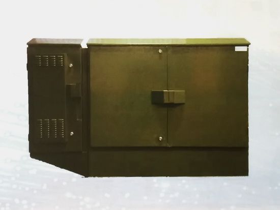

FTTPod is available to anyone with deep enough pockets not just business , but you have to use an ISP that offer that Openreach product and has nothing to do with Gfast availability, perhaps the error the engineer made was telling you that Gfast was available....FWIW, Gfast modules are added the the ‘copper’ cabinet, so if you know where your cabinet is, you could simply visually check if there is a Gfast cabinet attached, then again a shell may have been provided but they never proceeded any further...but if no Gfast cabinet, definitely no Gfast.

How would I recognise the GFast cabinet? The engineer who told me about GFast being available had just returned from doing some work at the cabinet, so I assume (perhaps wrongly) that he must have seen the equipment in the cabinet.
7,533 Views
Message 19 of 22
Re: Can I get Gfast
Go to solution
It will look like this.

Thanks. I'll take a look next time I am down the road.
