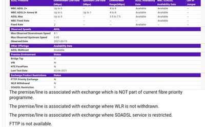

you are on adslmax where the max speed is 8mb down and 448kbps up.  from stats looks like you have max speed for adslmax
enter your phone number and post results  remember delete nimber

@imjolly many thanks for your reply.   Apologies,  I was totally confused & didn't realise 448kbps was the upload speed (I hoped it might have explained why my broadband is so sluggish, but not so!).
Anyway, thanks, I'll try and insert screenshot of results of the test you suggested

from checker results adsl2 is available to you but unlikely to give you any better down connection speed but would probably give about 100% increase in up speed.  adsl2 is bit more aggressive on any line noise so on your longish line may cause problems
if you think adsl2 would help you then mods may be able to help.  it may involve new contract but mods would advise
