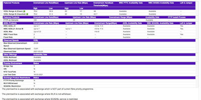

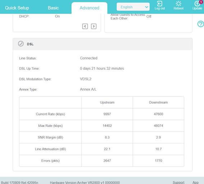

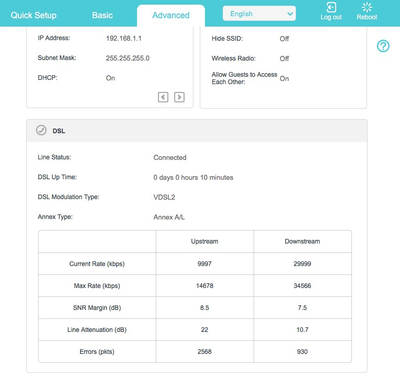

I have now tested my line via an old MacBook Pro with the Ethernet cable connected to a micro-filter and into the BT test socket on my NTE5a master socket. Not much difference it appears to me but about 2 more Mbps on the TP-Link VR 2800 sync  speed. Hope the images are large enough to read.

Your  connection is still terrible compared to your expected range from dslchecker results  your attainable is also very low and suggests a problem with your connection/line and I would suggest you phone 150 and get engineer visit

Just to add to @imjolly comments, the error packets for just 10 mins connect time looks very bad to me.
Also my attentuation is 33 up & 15 down and my speeds are approx 12m & 57m so with your far better (lower) figures you should be getting much better speeds.

Thanks for comment, I am not clear about the relationship between attenuation which is not dreadful and SNR and SNR Margin which I believe fall near the target figure BT use to decide the DLM setting. I am not ANY kind of expert though!

Not near enough target SNR and shows a line problem. With a good line on a Huawei cab your noise margin should be about 3.0dB with G.INP or 6.0dB without.

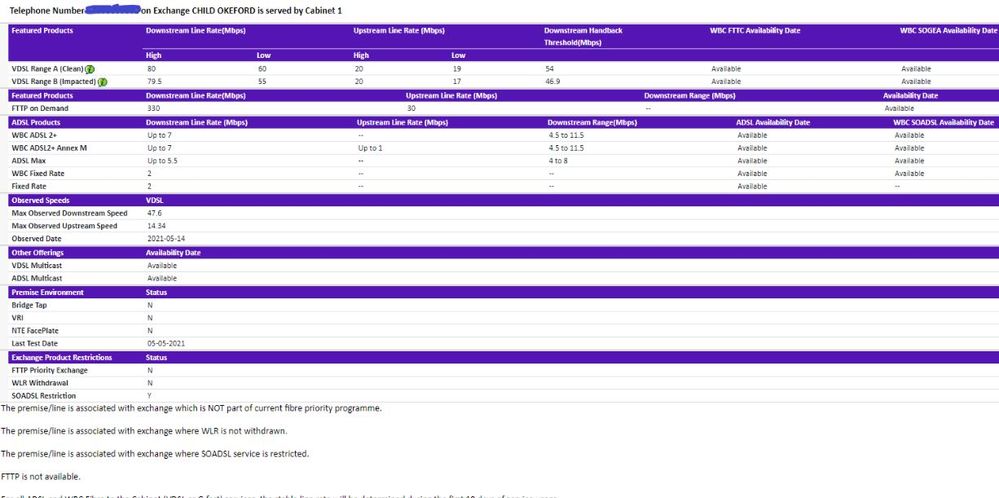

I have posted the results after the DLM has gradually increased the line speed, a terrific improvement! Downloads via oopla @ 42+ Mbps are common now, not 26-27 Mbps as previously. My line is close to the 50/10 profile stated by the engineer.BT line copy.jpg
