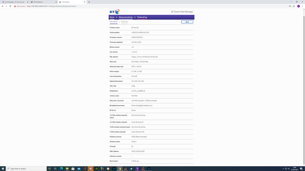

Capped linespeed
Desktop Screenshot 2020.08.23 - 14.00.47.00.pngHi so i joined BT and these are the speeds they have given me.
Normal available speeds
Your normal available download speed will be between 29-36 Mbps
Your normal available upload speed will be between 5-9 Mbps
Minimum guaranteed download speed
Your minimum guaranteed download speed will be 25 Mbps
I am on superfast 2 with speeds upto 67mbps. Desktop Screenshot 2020.08.23 - 13.23.51.80 (2).png

Your line is incapable of Superfast 2 speeds. The 67Mbps is an average of everyone on Superfast 2 some get more some less.
Post your connections stats. HH5 Troubleshooting/helpdesk. HH6/Smart Hub Advanced settings/thechnical log/information.

@thomo2284
Your line speed range, for the distance you are from the cabinet, is 35-51 Mbs.
The test results indicate 38.51Mbs, which is within that range.

post the hub stats
did you move from a previous ISP?  if so what speed were you getting?

you currently have a 40mb connection on an attainable of 43mb.  however you are on Huawei cab so if you can keep a stable connection then DLM should activate G.INP which will give a small speed boost and noise margin drops to 3db
