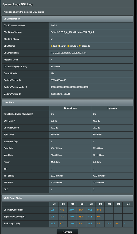

Attached is my DSL log, if that helps.

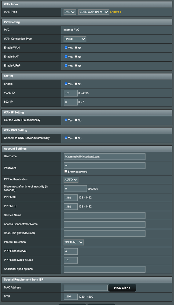

These are my WAN Settings:

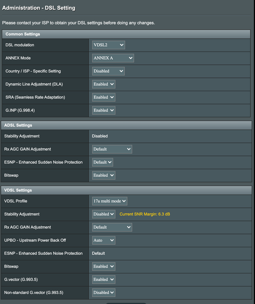

These are my DSL Settings:

@adam2311
Well all your settings look absolutely fine , very much in line with my AC68U.
Try & post the System Log where it disconnects as that might be helpful.

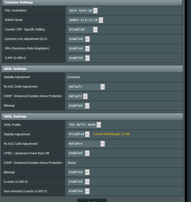

These are my dsl settings:-
The differences with yours are not significant but just my choice.

I've copied your Rx AGC GAIN Adjustment to see if I can improve my speeds.
