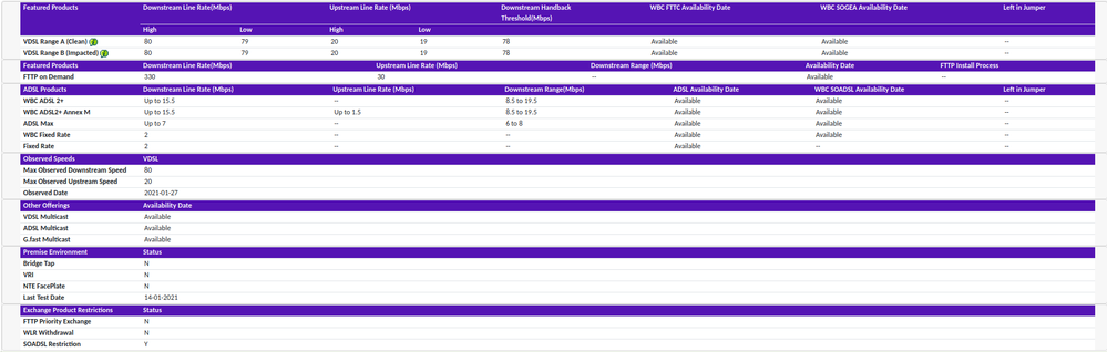

This is the BT Availability Checker for my line, in case it helps:

The answer would be yes, you would lose your current connection, and if the cabinet became full, then you would not be able to get a fast connection.
Only the availability checker would be right, but this is only updated once a week, so the cabinet could easily fill up with pending orders from any provider, especially as more people are working from home.

If you migrate from one provider to another at the same address there should be only a brief loss of service.
It would only be if you moved that you would face an issue.
I left BT and joined another provider and the transfer was done at 5 am, I didn't even know.
You join the new provider who handles the migration.  You don't contact BT to cancel, or this causes more issues.
