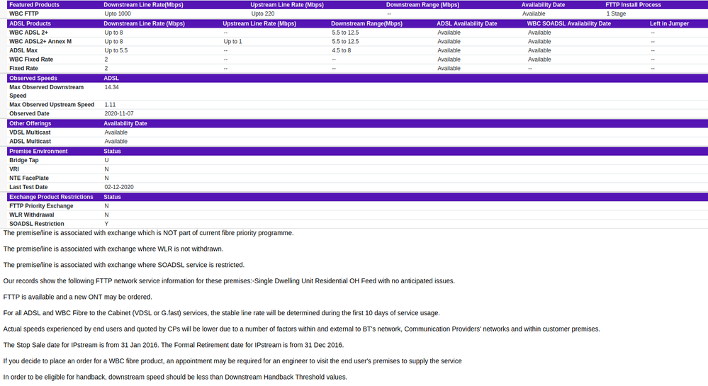

The screenshot shows information for our actual property, note that 'FTTP Install Process' records '1 Stage' - what does this mean

@Guzzigirl, welcome to the community and thanks for posting, are you sure you weren't offered a free upgrade to FTTC broadband? From the checker results, you've posted FTTP is available now and can be ordered with no issues anticipated. 1 stage means the installation should be completed in one visit.

1 stage means an engineer will turn up and get you connected in one go. 2 stage brings the fibre to the outside of the property then another engineer to do the install.
