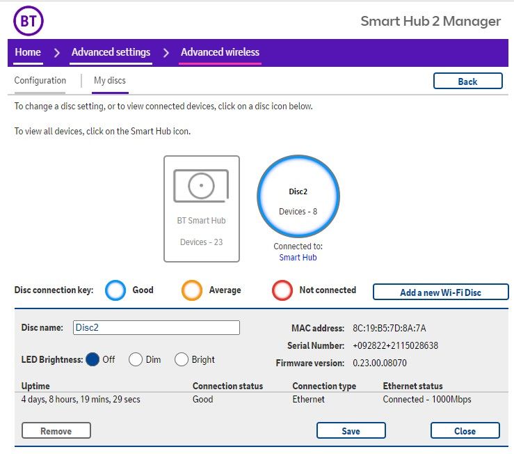

Hi @licquorice
Connected by Ethernet (via two switches)
And over WiFi

Hi @WateringCan   I flicked between the two connection types by simply plugging in the Ethernet cable and taking it out again. No configuration changes. See images above.
