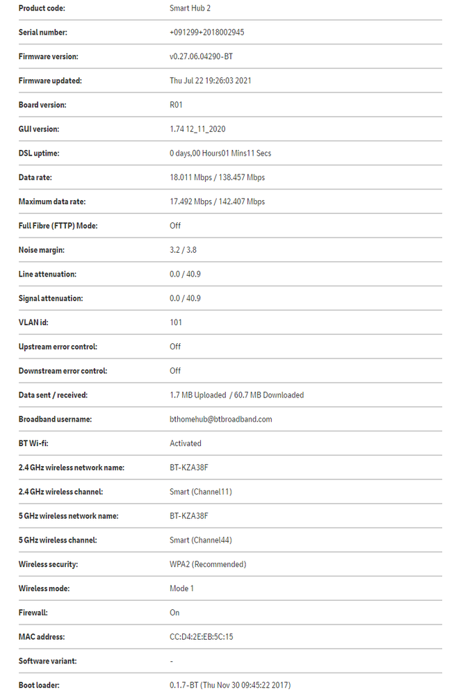

Please find below: 4.png

There's your problem, you have a G.Fast service which the Asus doesn't support.  You need the Asus DSL 88U to support G.Fast

Ah, aha, fair enough.  I got that asus router as it was the only DSL router that was AX. Ill likely return  the one I got and purchase the one you suggested in that case.
Thank you ever so much for your help, and for taking the time to reply to me.
