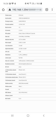

in order for the forum members to help please can you post the stats from your router (if hub enter 192.168.1.254 in your browser) and if  HH5 then go to troubleshooting then helpdesk and if HH6/SH2 then advanced settings then technical log information .

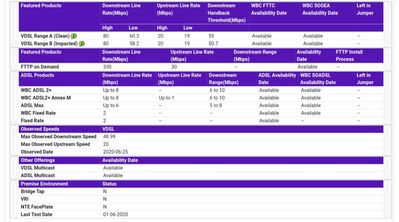

enter your phone number and post results  remember to delete number   https://www.broadbandchecker.btwholesale.com/#/ADSL

Message 4 of 15
Re: Connection dropping repeatedly, multiple engineer visits

Message 10 of 15
 One of the recent examples of the connection droppint.
