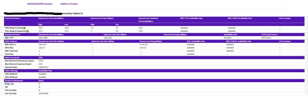

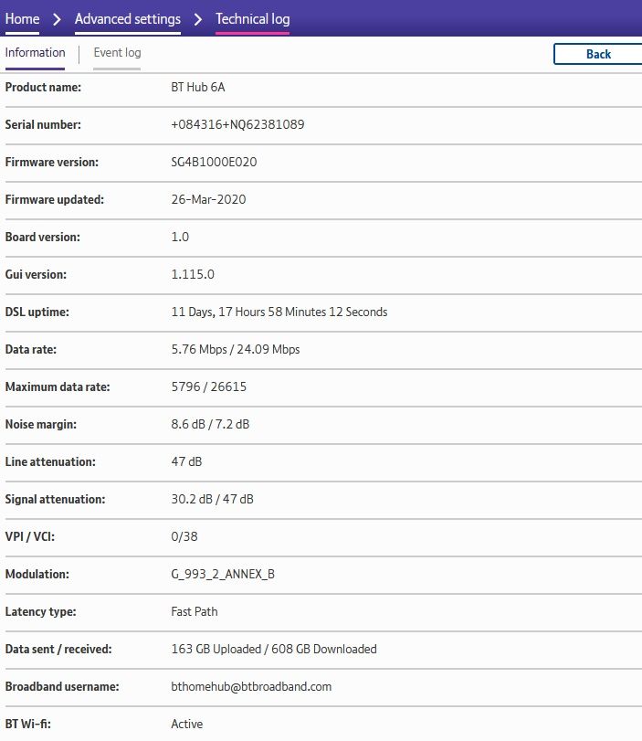

in addition to information requested by @DavidM  please can you post the stats from your router (if hub enter 192.168.1.254 in your browser) and if  HH5 then go to troubleshooting then helpdesk and if HH6/SH2 then advanced settings then technical log information .
Have you tried the quiet line test? - dial 17070 option 2 - should hear nothing - best done with a corded phone. if cordless phone you may hear a 'dull hum' which is normal
enter your phone number and post results  remember to delete number   https://www.broadbandchecker.btwholesale.com/#/ADSL
Someone may then be able to offer help/assistance/suggestions to your problem

from the information you have posted your expected connection range is 33/18mb and you currently a connection speed of 24mb so well within expected range.  your download speed is 20.7emb which is consistent with a connection speed of 24mb
so looks as you would expect
if quiet line test is not quiet then phone 151 and report a phone fault
