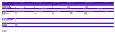

 If needed for clarity

if you have line noise even from the test socket then you need engineer visit but if no noise then must be your internal wiring and your problem to fix
if your current speed is 39mb then you are within expected range however as you have just moved in to new home and connection is 'new' you may be able to get engineer visit to sort your problem  you need to phone 151
as in expected range you are unlikely to get DLM reset unless engineer does it assuming you get free visit
