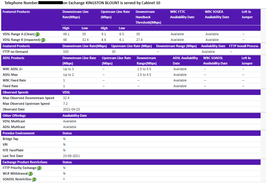

Hi,
I had a problem with my Broadband earlier in the year where the Downstream SNR would slowly decrease over a few days to the point of causing the line to drop and retrain.  This was resolved at the beginning of April 2021 by replacing the modem and removing the Ethernet over Powerline adapter that sat next to it.  The connection has been rock solid ever since.
Following a couple of power outages over the last month, the maximum achievable Downstream and Upstream line speed has increased, but the connection has remained fixed at 32,400kbps Downstream and 7,200kbps Upstream.
This looks like the line has been banded.  How do I request a DLM reset to remove the banding?  Line stats and results from the BT wholesale broadband checker below.

Certain!y looks like you are in a banded profile due to connection problems. It looks like you have been on 32.4mb since aprilaccording to dslchecker and currently have 14 days stable connection.
I have asked mods to have a look and see if they can help you.  They will post here

Hi @japage33, welcome to the forum and thanks for posting. Sorry that your profile looks like it has been banded. I've sent you a Private Message so you can get in touch with the team and we'll be happy to get this fixed for you.

Hi @japage33, has the banding lifted and your connection improved?

Hi John,
Yes, the DLM reset has worked and the banding has been lifted. Thanks for your help.
