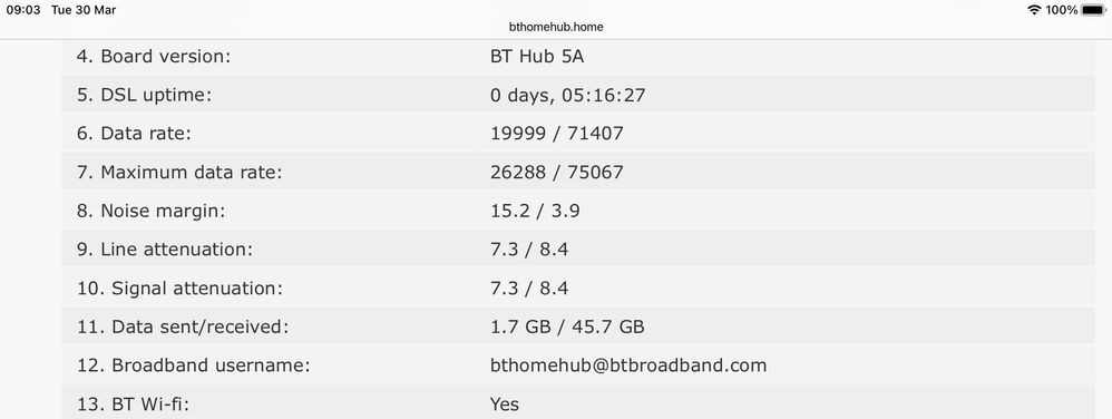

It’s taken over 10 weeks, but g.inp looks like it has finally switched on, ironically 2 days after I switched back to the HH5 for unrelated reasons. My TPLink started getting very hot, uncomfortable to touch in fact.
Still not perfect stats, but very much in “that’s good enough” territory now. It looks like there is scope for a slightly higher whenever the next resync happens too.
