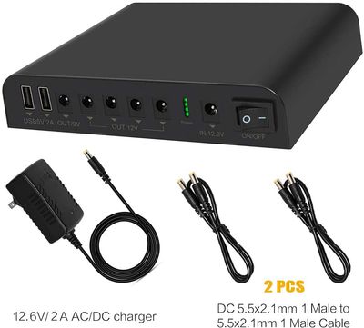

I've seen a few Lithium-ion (li-ion) battery options too on these mini-UPS units like:
TalentCell Mini UPS Uninterrupted Power Supply 27000mAh
There's several models most come with the appropriate 12v barrel plugs. Reviews seem to be pretty good.
Just make sure you get one with a UK plug if buying for someone else.

@FTT
The TalentCell unit looks useful for anyone needing to power multiple devices; it has some good reviews (but also some pretty bad ones).
I noted that the TalentCell mini-UPS comes with 2 DC cables, but they're both fitted with the 5.5mm o/d x 2.1mm pin plugs.  In the sales blurb on Amazon they state "if the size of your device input port is not DC 5.5 x 2.1mm, you need to buy the proper chord or adapter separately.".  In my experience that means "go find one" not "we can sell you one".  I went to the TalentCell website, but couldn't find any mention of available accessories (or indeed of their mini-UPS!).
It's always worth checking directly with the supplier to make sure the UPS comes with either a cable or adapter that fits the BT Smart Hub.  Most (if not all) have the "standard" 5.5mm/2.1mm plug on the end of the DC power cable, so either a replacement DC cable or an adapter is necessary.  You'd think it would be pretty easy to get hold of a suitable adapter, but although there are many adapters out there very few accommodate the 3mm pin in the BT Smart Hub 2 DC input socket - the correct plug size for the SH2 is 5.5mm o/d x 3mm pin; a plug sized at 6.3mm x 3mm pin will also work, although it's a tight fit (I've also  successfully used a plug described as 6.2mm o/d x 3mm pin, but I believe the 6.2mm and 6.3mm are actually the same - mine both actually measured 6.25mm.  The adapters all need to fit onto the 5.5mm x 2.1mm pin DC supply cord plug.  Issues I've had in finding the correct adapter are:
  • Supplier of my original UPS included a set of 10 adapters, one of which was the 6.3mm o/d x 2.1mm pin item.  I recently bought a second identical UPS but the supplier no longer includes adapters; I was advised to look for a third party supplier.
  • The correct plug is sometimes described as a Philmore 206, but the manufacturer of the plugs doesn't make adapters (and is out of stock of plugs, although I'd prefer not to rewire anyway).
  • I did find an adapter set identical to the one originally provided with my first UPS, which as stated had the 6.3mm o/d x 3mm pin included - but it's an expensive way for a single plug.
  • I've seen some small UPSs that specifically claim compatibility with the BT Smart Hub 2, which is probably accurate in terms of power requirements, but they still don't have a compatible plug.
  • The supplier I eventually found  - Power Adapters UK  (they do "exactly what it says on the tin") - carry a large range of power supplies and adapters, with images and dimensions of each item.  They probably won't recommend an adapter for a specific device, so knowing the correct dimensions is important.  They told me they only had a limited stock of the 5.5 x 2.1mm pin to 5.5mm o/d x 3mm pin adapter - but I only wanted 3 and they consider 100 limited stock, so no problem there 🙂
