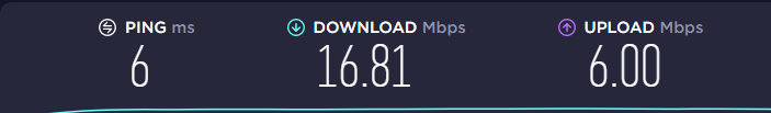

This is my speed now it seems, my stayfast is 21Mbps and I haven't hit over 18 for about 3 months, yet I'm still paying £55 a month for Broadband and calls

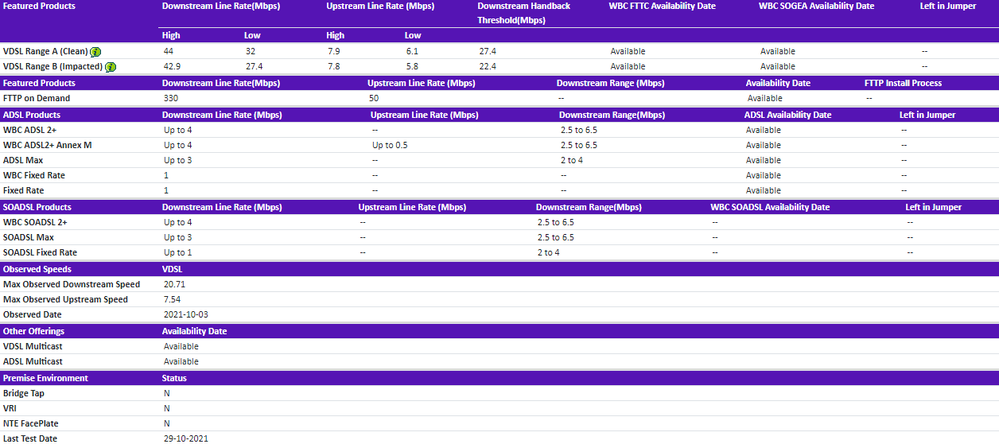

BT wholesale Broadband checker still says the cabinet can do 45 but apparently the max observed speed is only 20 and I haven't even hit that (I was getting 45Mbps 3 months ago, I'm about 100 metres from said exchange, my contract ran out about the same time this started happening and the pessimist in me thinks that's conveniently timed...
