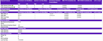

And this is the info for the landline.
Using a cordless phone, dialling 17070 and option 2 for quiet line test, it is silent with the odd crackle every now and then.
Thank you
