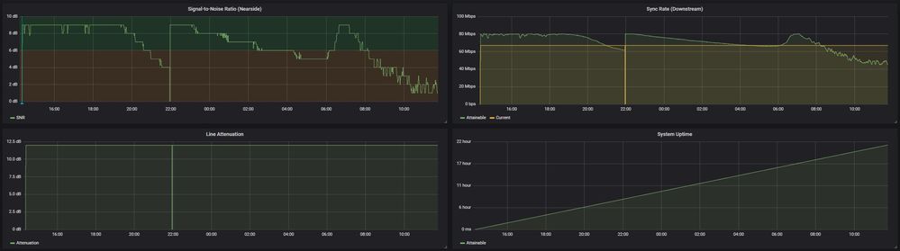

Ok after recording the statistics for a few days.... things are just super-weird. I even bought a second Vigor130 as I figured my modem was broken....
Here's a graph of SNR, the current/attainable sync speeds, line attenuation, and uptime.
Modem booted at 14:20 yesterday. DSL cable reseated at 22:00 last night (note the SNR recovers immediately when resyncing).
Any ideas?! I've sent this to Draytek too for their opinion...

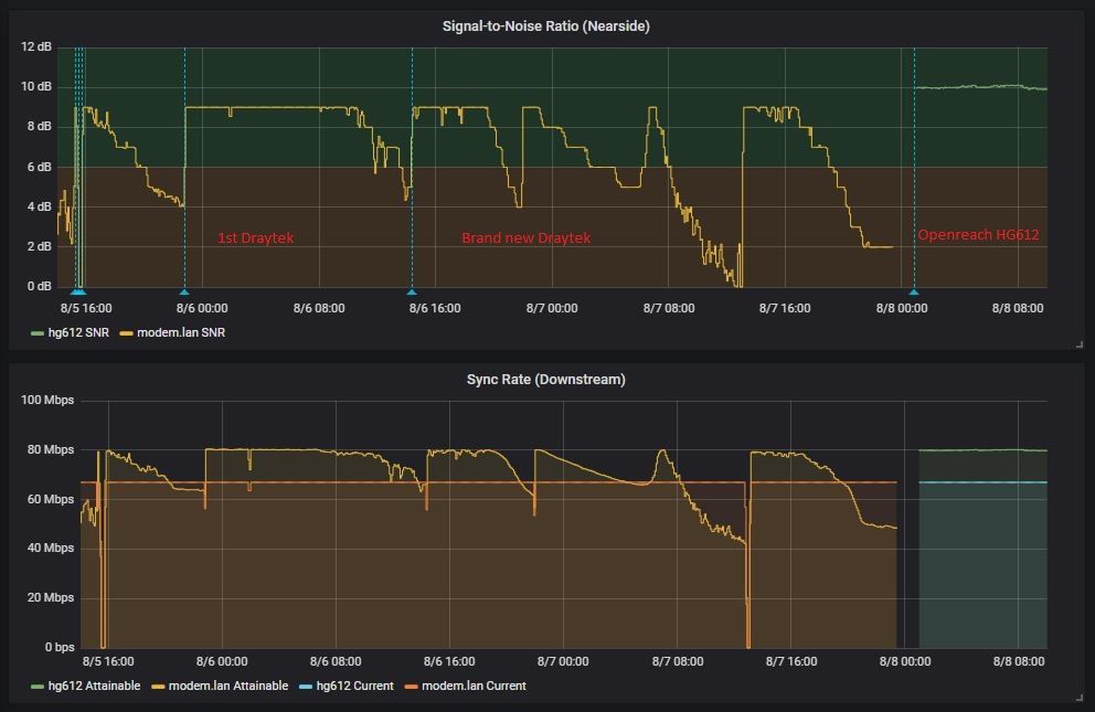

Ok - suspect this is a Vigor issue (either Lantiq chip compatibility with my cabinet or a firmware issue). I switched back to the old HG612 (unlocked it for stats) and it's night and day....
The below has two different Vigor 130 in use (I bought a 2nd in shear frustration)....

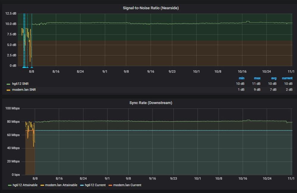

Any chance of the moderators performing a remote DLM reset? I've now been stable on the HG612 for over a week, and the attainable speed is ~81Mbps (and constant SNR of 10dB).
Thanks!

Coming up to 90d later and it's still exactly 66999kbps....
Modem has been rebooted exactly once (and left off overnight) on the recommendation of a friendly Openreach engineer.
