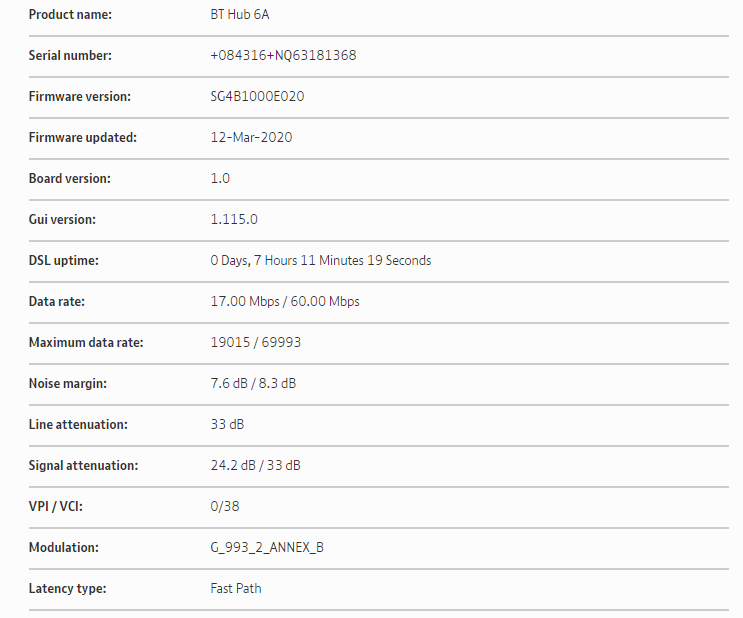

Post the connection stats from the hub. Advanced settings/technical log/information.

This screenshot was 12 mins after the reconnection. Need to find a corded phone for the quiet line test.

Your noise margin is very high at 17.6db, normal is about 6db, suggesting problems with many drops in connection and probable line problem.  Trying quiet line test might confirm

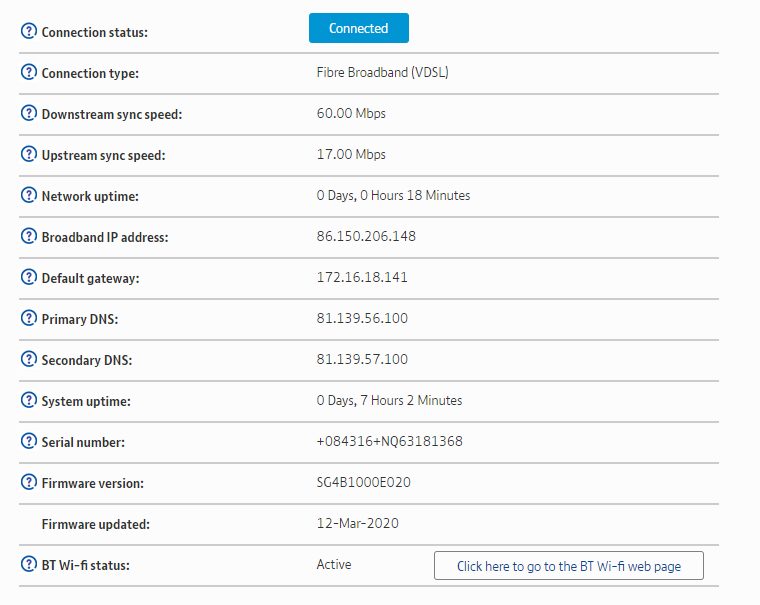

Just had a look at the HH. Noise down to 8.3
Seems it went off 7 hours ago; Odd that no one noticed usually the child would kick off 🙂
