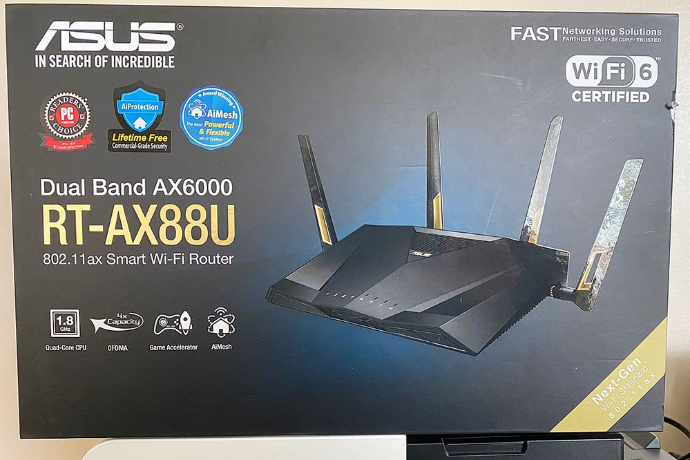

@Will168
Buy once buy right.
I still have my Smart Hub 2 sat in it's box brand new as I took the Asus RT-AX88U route.
Spent many hours on this (and other forums) and confirmed this router did the job fine so made the purchase.
Expensive (like your Deco M9's are) but again we both have proved better hardware does max out the premium 900 / 110 package with ease. 🙂
