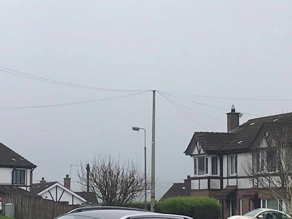

So I had a look outside and it looks like some properties down the street from me are served by overhead cable - picture below. But I live at the end of a cul-de-sac so there are no houses directly beside me that are served by overhead cables. It looks like they stopped at a certain point - closest house to mine served by cable is 5 doors down or across the road.
Will it come down to how far the cable can be run from distribution pole to my house if I can get FTTP or not? From reading other forum posts there was a 68 metre limit for dropwire, is that the same for Fibre? https://community.bt.com/t5/Archive-Staging/What-is-maximum-length-of-drop-wire/td-p/399881
What are the chances of a new distribution pole being put in place?

There is a span length maximum ( it could be 68m , but others may know for sure ) ,and there has to be a minimum height over the road.
The pole looks like a hollow pole , so the usual attachments to connect the fibre drop wire to a wooden pole wouldn’t be usable, this could cause issues.
There is a contributor Starwire who installs this type of thing, they may be along sometime and give an opinion on if your install will proceed without delay or if it needs to be reassessed.

O/H FTTP Drop Wires can now span to a maximum of 75m as they recently changed the rules.
If it’s not possible to provide it O/H from the Hollow Pole to your house it would need to be sent for Planning and they’d come up with a solution, usually the cheapest. Could be they put another Carrier Pole in or they may have to do some maintenance dig work. Couldn’t really say without seeing Map for the street.

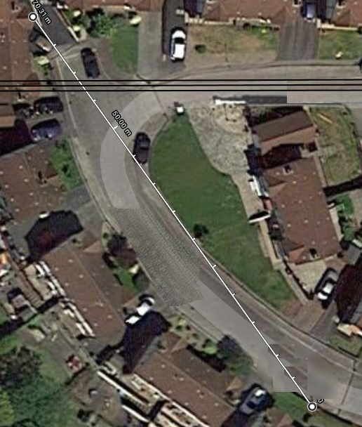

Thanks Starwire. I did a crude google maps measurement as the crow flies and it measures as 70.31m  - see below.
In between there are electrical wires which I have marked manually. Does that have any bearing. Would a fibre line be ok to go under the electrical wire which is quite high anyhow.
Do you know where I would find anything official about the 75m rule and the rules changing?
If they deem it needs to go for planning, digging etc, are they typically obliged to sort out a solution or could they just say it's not worth their while?

It’s possible the reason your property is served underground could be the overhead power , there has to be a minimum separation between the power and ‘phone line’ , the phone line being below the power ( so if it dropped it wouldn’t sit onto of the power ) it’s possible that the height over the road and the separation under the power cannot both be achieved, and that’s why your existing service isn’t overhead, unfortunately when your address was surveyed, it was probably a desk survey and an assumption made that overhead would be OK....it may still be OK, but better to be prepared for delay rather than it coming as a surprise.
Chances are any extra expense OR would foot the bill, not you.

Is the Power High or Low Voltage?

look like low voltage lines, they're not connected to any local pylons anyhow. Does it make a difference?
