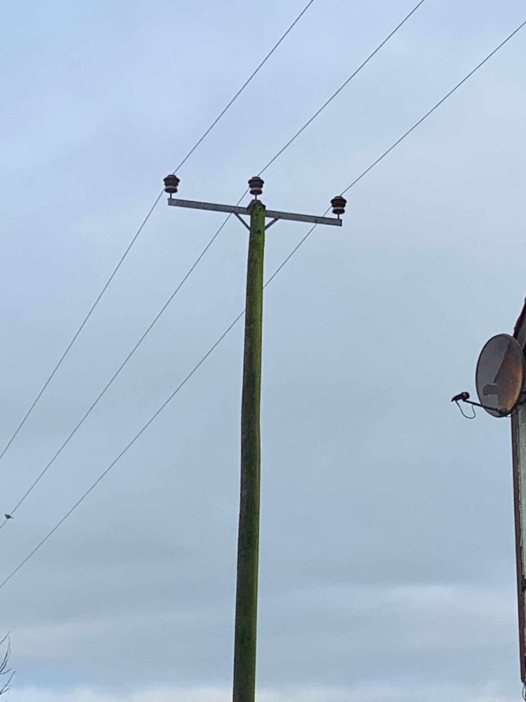

Here's the overhead line. Could overhead fibre lines be run under these power lines?

That is high voltage, I suspect @Starwire  will be along at some point to confirm if it is possible, but I suspect not.
10,049 Views
Message 13 of 31
Re: FTTP Install underground v overhead
Yeah, that’s HV. It will either be 11k or 33k
11k you can put drop wires under them but with a minimum clearance of 1.8m. Bear in mind the drop wire needs to be at least 5.9m above the road.
If it’s 33k then you can’t put drop wires under it all.
Given your end of the road has the phone lines UG I’d hazard a guess it is 33k anyway.
