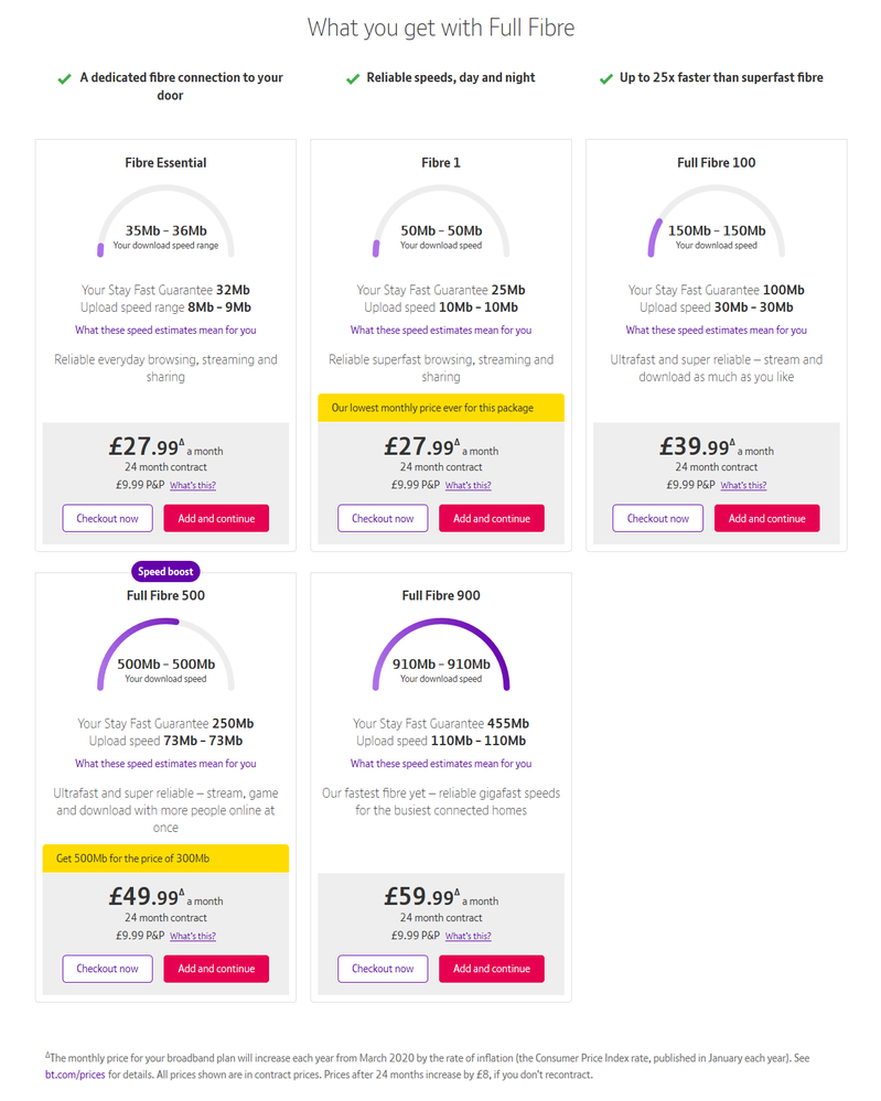

@Will168
When I checked yesterday and the same package (900/100) at Zen is £62.99 vs. £49.99 at BT and £54 at EE.
____________________________________________________________________________________________________
Mate you have done well getting the premium package at £49.99 that's a fact, usual price is £59.99.
I got mine in the Black Friday deals with free installation (usually £9.99) and the first three month free making a good saving but not as good as £10 a month cheaper over 24 month.😮

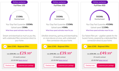

@busterboy1
Apparently it is a regional offer. But it's been that price for a while here. It says £9.99 P&P, but I did mine as part of a house move and they never asked for the £9.99 or any installation costs. They sent me a SH2 at the same time for no additional cost.
