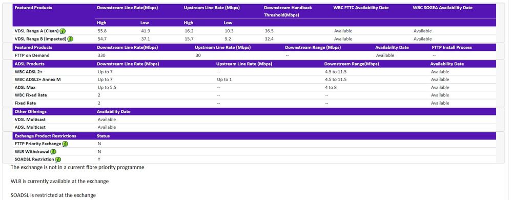

Hi @kevinroy welcome to the community and thanks for posting. Can you post the results from this availability checker and we'll take a look?
Make sure to remove your address/telephone number from the results.

Hi NeilO ,
Picture as below, I do have the pole number etc if that helps.

As you can see from the checker result, I'm afraid FTTP isn't available to you.

Re: FTTP & Telegraph Pole
Hi yes it does say that at the bottom, but it also says FTTPoD is available, is this still a thing and can I get that then, and how do I go about doing that ?
Just seems weird that the pole has a caution overhead fibre warning sticker on it, when there are only 3 houses connected to that pole and no businesses and all older residents, and it stops at my address the two cables heading north from the picture go into a couple of senior aged peoples houses thats the lot.
FTTPoD is an extremely expensive roduct aimed mainly at businesses. Construction costs can be in the tens of thousands of pounds.
