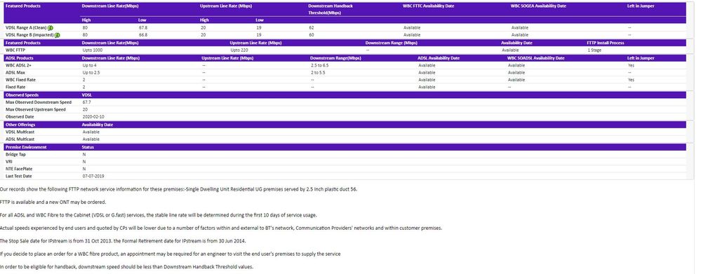

are you an existing BT customer?  if so enter your phone number if not use your address and post results  remember delete phone number or address

2,571 Views

this shows i have an underground duct - but as i said about this is now totally covered up by the new extension

Once they find the duct cannot be used as is they will detect where it is in relation to the outer wall, dig down, split the duct and bring back up on the outside. It won't be a massive hole or trech and they will make good at the end.
