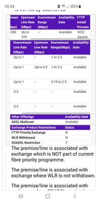

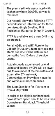

How do I post the results? My screen shots are to large to upload. Here is some information from the property search
It states ADSL Multicast as available
WLR withdrawn as No
SOADSL Restriction as yes
It says the premises/line is associated with exchange which is NOT part of current fibre priority program.
FTTP NETWORKservice information. Single dwelling unit. Residential UG partial direct in ground.
FTYP is available and a new ONT may be ordered.

use the camera icon to post
