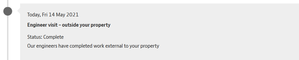

So we called BT and after them reassuring us that this would happen we ordered FTTP. We were given an install date of 25th of May and an engineer was scheduled to come out today to assess the install.
Well we just got the text to say that the engineer has visited and completed work outside our property but we've had someone at home all day and haven't seen anybody and had no contact from BT/Openreach other than the text saying the work was completed. Our order online has also been updated to say the same.
I still have my concerns about how they will actually bring the fibre to the house.
What happens on the 25th when they try to feed it through the duct that isn't there?
Will my current connection be cut off on the 25th on the assumption that our Fibre has been installed and we're left with nothing?
