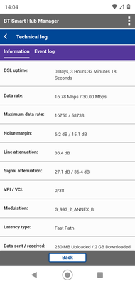

And for completeness, a screenshot of the new log:

Its DLM that is restricting your speed, another engineer tinkering about unnecessarily hasn't helped the cause.
