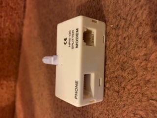

Just to clarify can I use any filter, I have this one that came with the tplink router. is this ok?
5,143 Views
Message 12 of 26
Re: PPP LCP send termination request (user request)
Yes, provided you can plug it in. They are a bit basic, but they do work. I have one which I use on part of my ADSL network to separate some line monitoring circuitry.
The purpose of the filter is to stop the broadband signal getting into the phone, that is all.

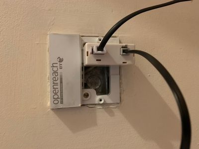

I’ve hooked it up. Looks like this now. Not aesthetically pleasing but as long as it sorts out my disconnects. Is there any worry about dust getting into the hole where the wires are? Should I try and cover it somehow, I don’t want the kids poking into it....

That is just fine. Do not worry about dust, but you do not want anyone pulling the loose wires out, as it may cause the main incoming pair to become disconnected from the back of the faceplate.
If that fixes the problem, then there are alternative filtered face plates which you can use, and they are of a less complicated design.

It will just eliminate any possible issues with the NTE, but there could still be external problems, usually affecting people who have an overhead feed from a pole. Intermittent faults can be hard to find.

So just an update after connecting directly to the master socket with a filter because I was having an awful lot of disconnections due to this ppp lcp issue.
I’ve now had uptime of 9 days straight which is great, I know it’s still early days. Does this mean that the mk2 faceplate is to blame?
do you think if I change it with a mk3 faceplate or similar it will be ok? Or can I leave it plugged into the master socket indefinitely? Btw I am using the tplink vr400 router atm.
