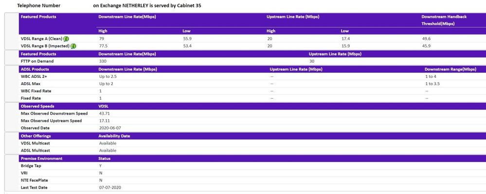

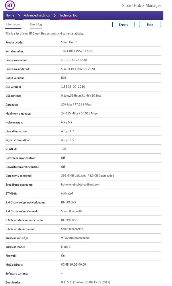

So fast forward to today, I am still only getting up to 44mb on my line from the cabinet to my hub when I have checked through the 'My BT' app speed test. I have attached the stats and what not, are there any suggestions as to what I can do?
Please note: The switch over to the new fibre with halo 2 was on the 13th.  The bridge tap result on the second screenshot has been rectified with the new NTE5C faceplate installed.

Connection time is only 1 hr is that hub dropping connection or manual reset?
from the hub stats you have an attainable of 66mb so you should get closer to that than current 47mb and you need to maintain a stable connection with no resets
is there any line noise. Dial 17070 option 2 should be silent and best done with corded phone

Once your connection is stable with speed nearer attainable then hopefully DLM will activate G.INP which would give you a bit of a speed boost but needs to get stable connection first
