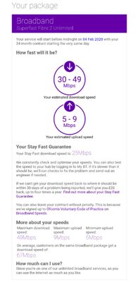

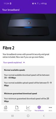

I just did the speedtest from bt app, these are what it's saying currently:
First image shows that minimum guaranteed speed is 25Mbps.
Second image shows that speed to the hub is 17Mbps.
It has the cheek to say that speeds are as expected - I should expect to have my hub connected at a rate significantly lower than I'm guaranteed?!?
According to their own blurb it's less than half of what's normal, so how can it be claimed to be as expected?

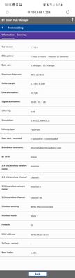

4,171 Views
Message 9 of 19
Re: Frequent disconnects and poor speed
Not only is your connection speed low but your attainable is just above your actual.  Have you tried connecting to the test socket with a filter and then repost stats to see if that improves your connection by eliminating your internal wiring and master faceplate
