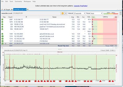

Fttp just pausing for 3/5 seconds every now and then. Anyway to stop it?
I have bt halo 250 at 300 Meg down 49 Meg up. Low ping (under 30)
Speeds, pings are good but I'm getting wha I can discribe as outages where I just get no net for a few seconds.
I got ping plotter for the past few hours and have noticed the packet loss / loss of net for between 2 and 5 seconds regularly.
 thats 10 outages in 3 hours. Which I think is a but unacceptable.
Can anyone help as I don't know settings in my bt router for fttp. And when do I contact bt about it?
Thanks.. Td

Hey, just commenting to confirm that I have a very similar issue. I've tested everything I can think of. Very quick disconnects every 15-25 minutes which has been ongoing for about 48hrs now. 31.55.187.177 seems to be the culprit? 92% packet loss for me.

Yeah same for me. 3rd hop, 9 minor dcs in the last hour ip address is 31.55 186.181 for me.

Nope. Just had a 3 second outage which shows up on my ping chart as complete packet loss. Lights on wall box dide t change.
Had over 20 of these since 1am.
Iys frustrating. Might turn off and on the wall box.

I reset the wall fibre and its still the same. Here's rhe last 6 hours. The thick red line is me resetting the router.
I think I better call bt.

Did you have any luck calling up BT? Still experiencing 80% packet loss with hop 3 and now wondering if I should give them a ring too.

I've noticed a few packet losses on the bt hub now to. 192.168.1.254 I've changed cables no go had 8 more "drops thst arnt drops" in the past 2hours. Going to factory default the bt hub.
