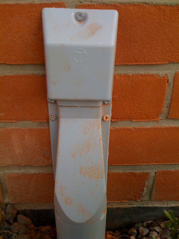

Will the fibre arrive at our property in the "T" box?
Thanks
Mozej

It would usually come in through that T Box, yes.
They can run it through that then extend the feed through your property along skirting boards if the distance isn't too long.
They may also be able to run it round the outside if your property to an entry point of your choosing, within reason.
It all comes down to the engineer who comes to install it and whether they intend on installing an external CSP (customer Splice Point) which is a grey box that contains 2 lengths of fibre joined together.
What you want doesn't sound too unreasonable. Engineers are usually pretty flexible with location of the ONT/fibre modem.
