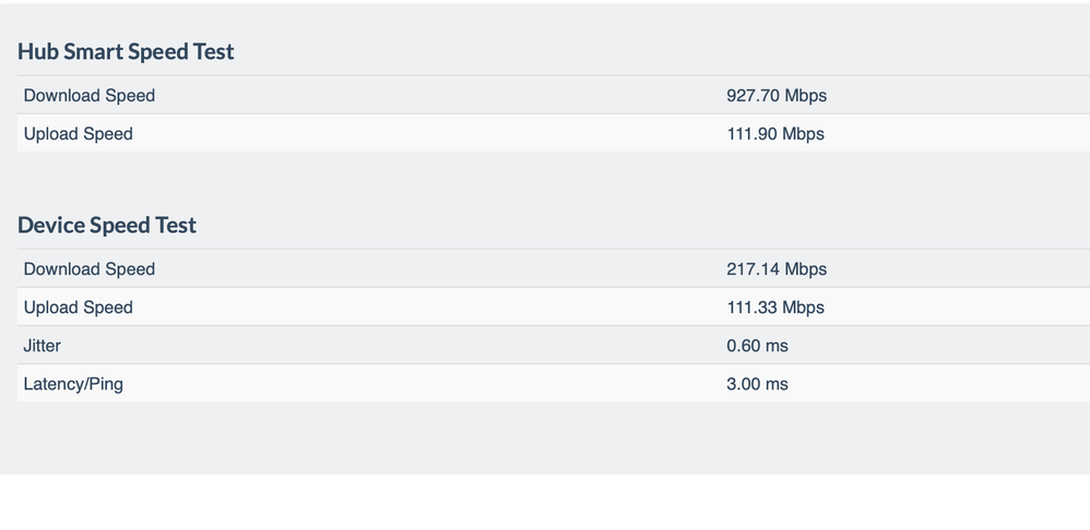

This pic shows my 2020 MacBook that is connected via Ethernet using 1Gig Port, cannot download at the speeds advertise. Same for every laptop in the house using Cat 6.
Hoping its a faulty ONT.
Screenshot 2021-09-02 at 17.08.07.pngI think I have to disagree with everyone here and kinda agree with the OpenReach engineer. Something is up with FTTP 900.
I had VM 500 package before and hit 600ish via Wi-Fi. With BT FTTP directly plugged into the ONT via Ethernet on a 2020 MacBook Pro that can handle the speeds I cannot get over 200mb mark.
I have spent hours on this, BT coming out tomorrow to take a look. There speed test shows I am downloading at 900mb+, however, I believe that speed test is the speed between my house and the Exchange. No other speed test fast.com, speediest, Google fibre, other shows these speeds.
I can only assume, they are miss-selling and showing speeds between my house and the Exchange, not real world. BT keep saying it could be Wi-Fi issues when this is over Ethernet.

@qs123456 I know we've had conversations about this on the thread you started, but one thing I'm not clear on...when you say the BT speed tester, are you referring to the BT Wholesale Speed Tester or the one you run from your BT account after logging in with your BT ID?
If it's the former, then there have been many reports of the BT Wholesale tester showing wild speed results with Macs. I myself get a result of around 3.5 Gbps on that tester (2016 MBP), which is obviously not right. If you are seeing 900 Mbps on that tester, I would imagine that real world is actually only about a third of that. In which case, your service is not right and BT and Openreach need to figure out what is going on and fix it.
If it's the latter, then it means you are getting the 900 Mbps to the Hub and there is something wrong either with the Hub itself, your device, or something inbetween. It is not mis-selling, but there would surely be something wrong there if the Hub is receiving 900 Mbps and your device, which is plugged in directly via ethernet is only getting a fraction of that. There are overheads and losses to be expected, but not that much!

Hey @Will168  - I've got the Belkin and when I check on my managed switch it shows 1gig connected. I'm having this issue on all my devices connected via Ethernet. My sister had a HP Business Laptop, Mum has a Lenovo business device (working from home) same issue.
Wi-Fi is hitting 200mb as well. With VM I had 1Gig and got over 600 on a Wi-Fi connection. Its so weird, I don't know why I am facing the issue.
If you can shed any other ideas let me know. I've tested my cables with my managed switch too, all 1gig connection.
- You are right BT Wholesale test is a mess and after logging in I get 900mb speed test. I also have been given access to another speed test which shows device speed test and hub speed test as shown above.
This is driving me insane, I can only assume faulty ONT box? or if the engineers wires up the ethernet port, maybe a doge job?

The screenshot you provided above, where is it from? I don't recognise the interface as being the same as my SmartHub 2.

@Will168 - You are a very nice person. Thank you for doing that. Yes something is wrong with my setup. That speed test was sent to me from BT, you login to it (different login details to My BT account)
I will have an £80 bill added to my account if BT come out and deem nothing is wrong, so these tests you've done make me feel more conformable.
I will update this thread with the outcome of BT engineer. A friend is coming over tonight with a 10gig ethernet port on his Mac mini to rule out issues. Just don't want £80 bill and really want BT to acknowledge this issue..
