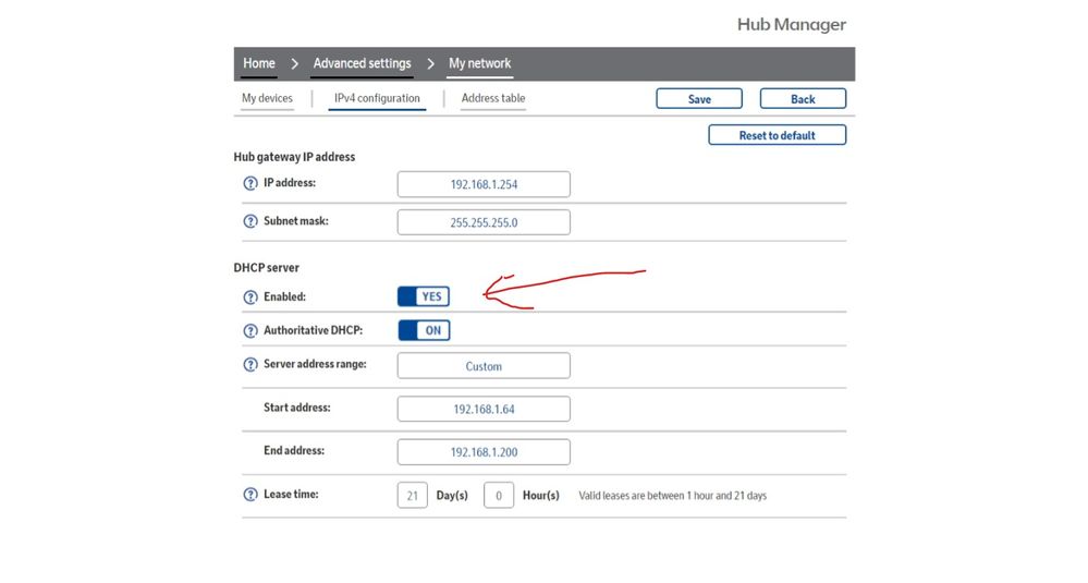

To disable DHCP:-

@KennethS wrote:
@imjolly -- that is interesting. When I was searching the forums I could not find any instructions on how to disable the DHCP server in the SH2.  A call to BT technical support was unhelpful as they said it was not possible. I will do another search now, mostly as a learning experience since I am quite happy with our home setup and have already moved to a different VOIP service for "landline" home phones.
Disabling the DHCP server does not prevent double NAT, nor does it stop the hub routing. It just stops the hub issuing IP addresses to clients.
