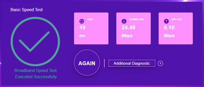

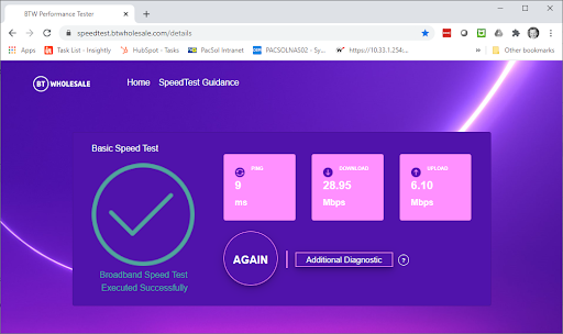

Just to confirm as I stated the router negotiates the expected line speed for the connection:
but as per this small sample from Monday, this is the problem I experience throughout the day BUT it is not consistent, the performance drops in and out:
and this very second when I test:
but that won't last...

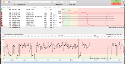

When using pingplotter for diagnosis is does matter that it is a wired connection and not wireless.

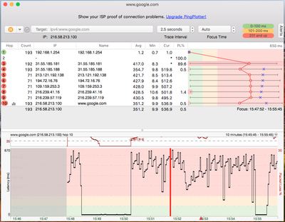

running the tests now - I'll let it run over a longer period but here are initial to Google (MacBook, Wifi disabled, wired (2m cable) connection)

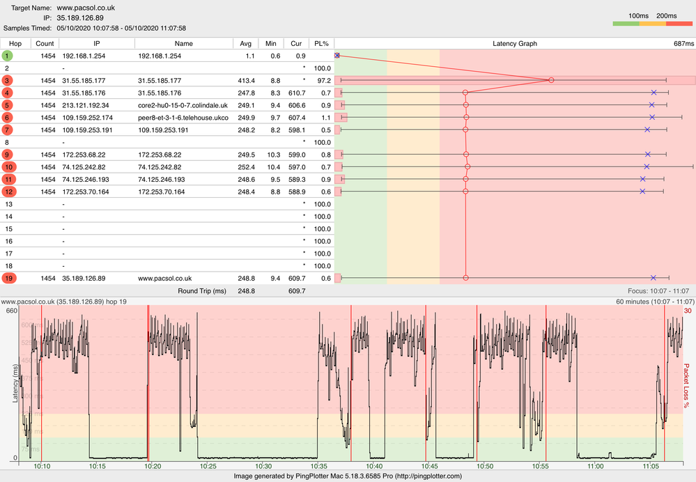

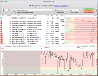

The longer version:

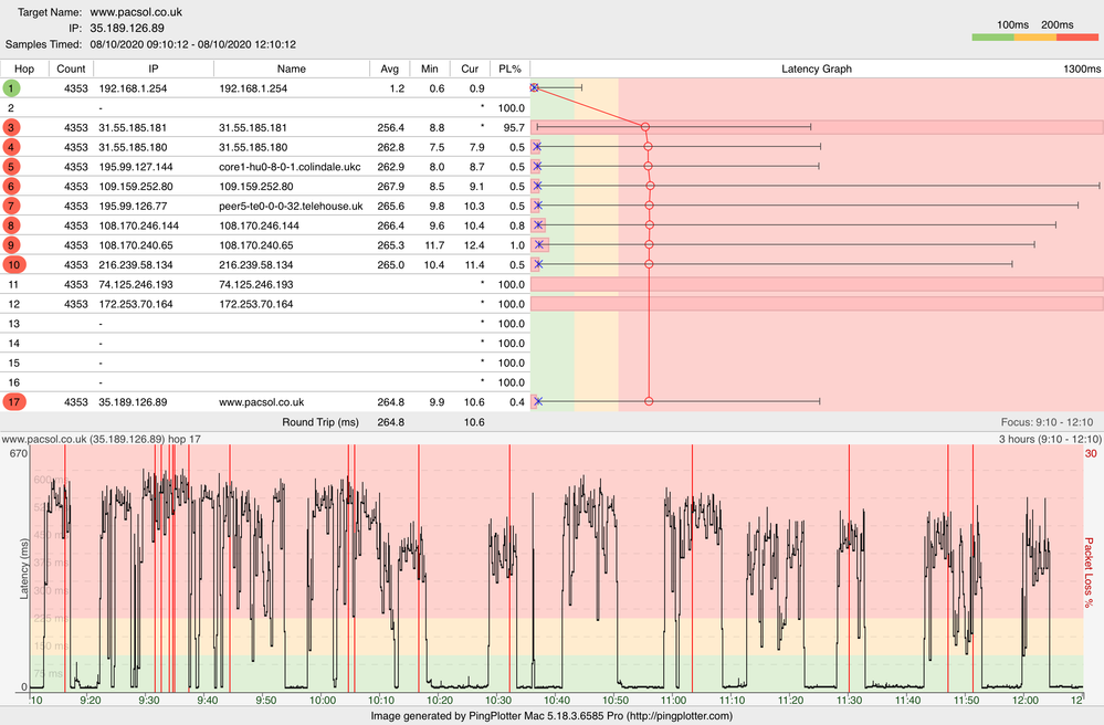

Open for comment - does anyone dispute that the issue (as shown in the attached) is caused by congestion at the point my connection enter as the BT ISP network. Essentially - there is nothing wrong with my line but rather the service being provided by my ISP's infrastructure?
This was conducted via a wired connection. There was no streaming / downloading occurring during the test. As well as the test device, there were two active devices (office laptops) using web tools and collecting Outlook mail.

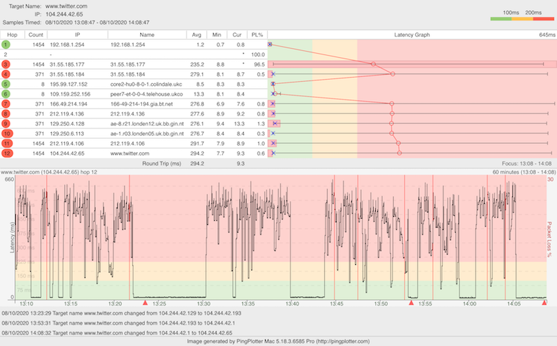

Adding additional data for my BT communication (over 95% packet loss entering the BT network):

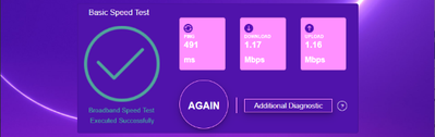

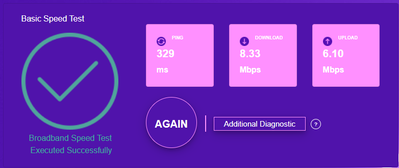

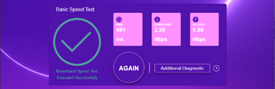

Quick line test as I do most mornings that demonstrates the issue in two simple screenshots taken 15 secs apart with absolutely no change in my network environment (just pressed AGAIN):
first capture at 0915first capture at 0915...15 seconds later...15 seconds later
