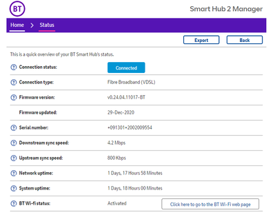

eventually i noticed on when connecting to the Smart Hub 2 Manager with ipad, that the connection type is listed as "Fibre Broadband (VDSL)".  My old router is ADSL so that explains why it no longer connects...
and i did some research and found for rural folks like us and 2.5km from cabinet/exchange that you can get poorer connection speeds with VDSL than the ADSL 2+ we had before.
is it possible to have our broadband connection changed back to ADSL 2+ and increase our broadband speed from 3.5 MBps back to 7 Mbps ????  since this VDSL is pretty limiting and impacting my working from home experience.
