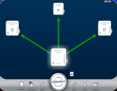

Good news!!! Finally got it to work. The power adapters are by Devolo so downloaded the "Cockpit" from their website. This is a helpful app which identifies the network of power adapters and tells you which ones are working. Then reinstalled each power adapter one at a time so I could indentify them ( via the cockpit).  Managed to rebuild the whole network again and now all working correctly. No idea why it stopped working in first place though. Did not plug anything new in that I remember. Thanks for the helpful suggestions
